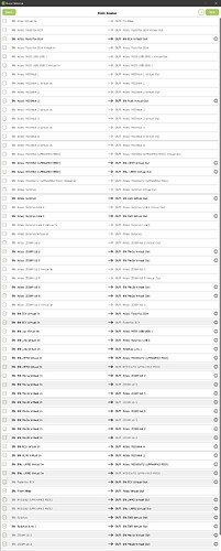

Connecting Bome Network Pro on my Workstation (‘Husky’) to Bome Network Pro on my Laptop (‘Atlas’) over Ethernet. Works great. Except … I get a slew of auto-generated MIDI Routes. No clue what they do or if I can get rid of them.
Here’s a screenshot:

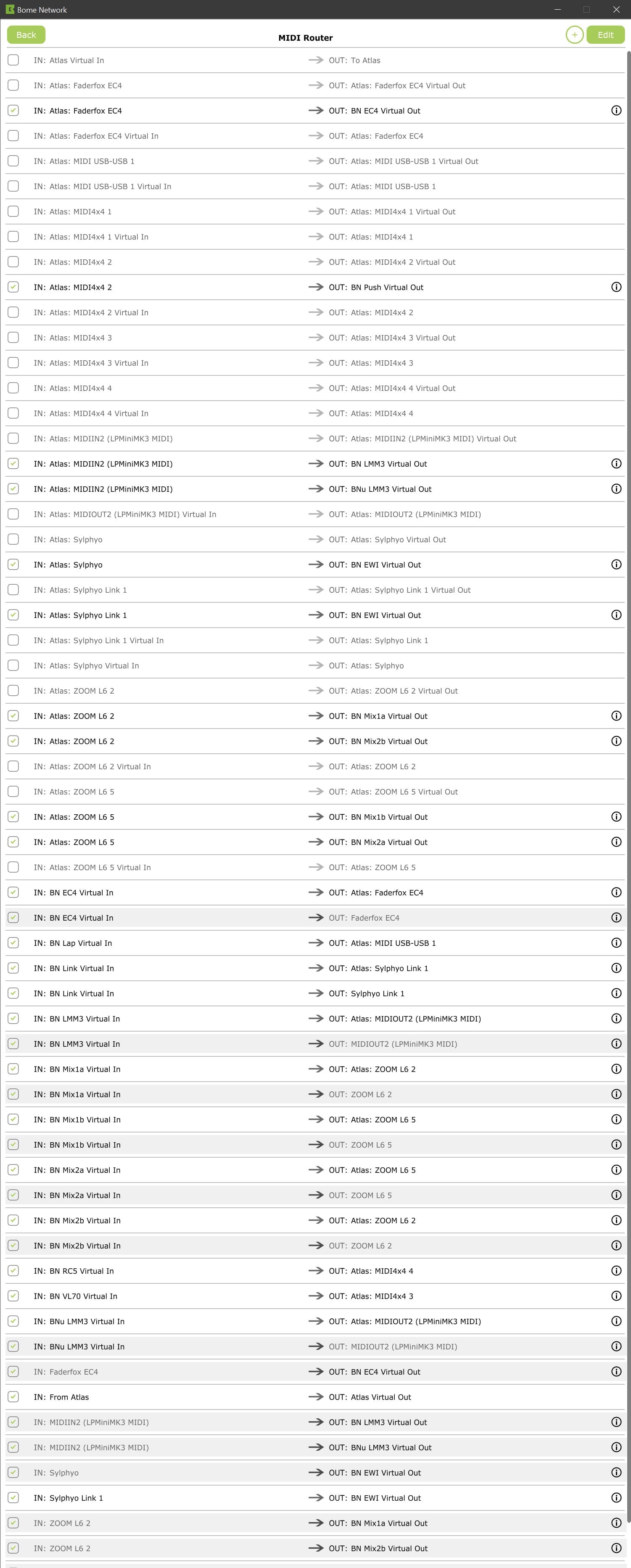

The second entry - [In: Atlas: FaderFox EC4 → OUT: Atlas: Faderfox EC4 Virtual Out] - is a good example. What does it do?
The ‘real’ entry I need was entered by hand: the third entry - [In: Atlas: FaderFox EC4 → OUT: BN EC4 Virtual Out]
I’ve unchecked all the auto-generated entries, so it’s not a problem, but it sure does clog up my Routing Table …
