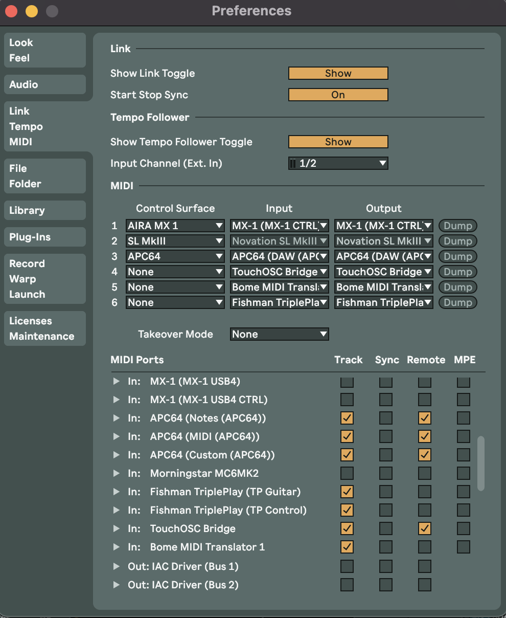

I’m trying to use Ch1 CC64 as a sustain message for all midi instruments in Ableton. Seems simple enough, but though the translation is making it through, nothing is sustaining. Somehow in the recent past I’ve been able to get it to work intermittently, but now it’s consistently inoperable.

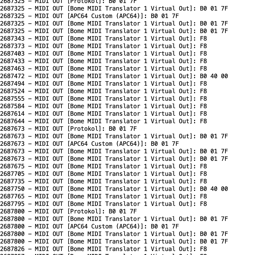

Here’s a snapshot of my outgoing log:
and these are my settings in Ableton:
Any ideas on this?

Hi, I would need to see the incoming log also. It appears you don’t have sustain-on in your outgoing log so you may have a problem with one of your translators.
Sustain-On would be B0 40 7F - Which I don’t see
Where Sustaion-Off is B0 40 00 - Which I do see.

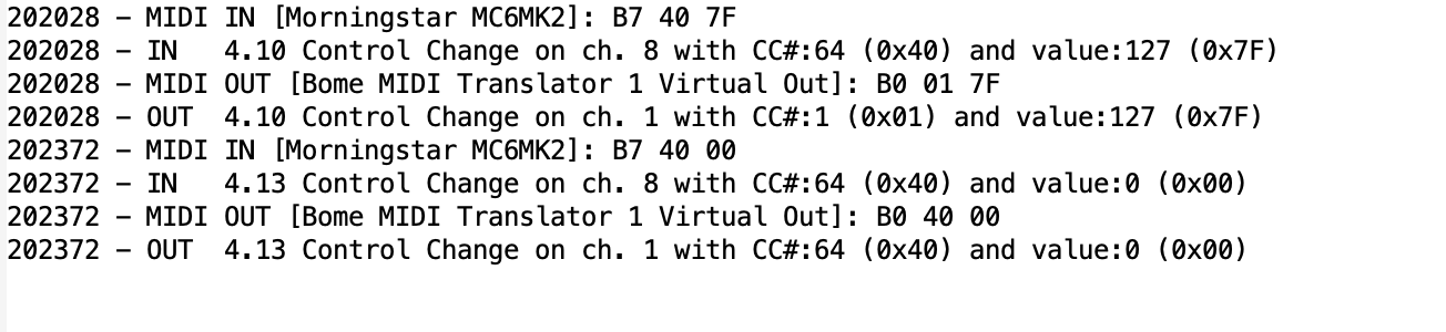

Hey Steve! Thanks for the quick reply. Here is the log window for when the sustain message is sent:
OK, so you are getting MIDI from your Morningstart MC6MK2 on MIDI Channel 8 with value of 7F (127). Are you trying to control your sustain with that device? I suspect that Ableton is looking for MIDI CH1 .
Also your device selection for your translator may be wrong. I would need to see the relavent translator of your project file.
If you check MIDI IN, MIDI OUT, Incoming, and OUTGOING. In the log window and then press and release sustain, we could see what is happening and whether it is being controlled by translators or a MIDI thru path.
You will see ‘Incoming’ if the trigger is in alignment with a translator, otherwise, you will only see MIDI IN.
You will see ‘Outgoing’ if the output is from a translator.
You will always see MIDI IN and MIDI OUT for any opened devices whether handled by a translator or the MIDI router (MIDI Thru path). (As long as it is MIDI data)
You also may need to address the proper device selection of your translator.
Edit: Translator 4.10 looks like it is converting from CC40 to CC1.

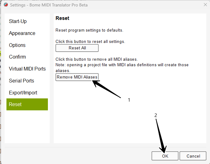

View->Setting Then Remove MIDI aliases.
Then restart and set up your aliases that you want.

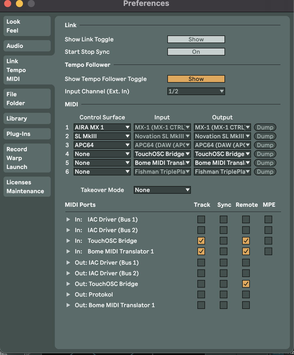

The weird thing is that if I uncheck ‘remote’ under Ableton’s MIDI preferences for Bome, it works! …the problem is I lose functionality with most of my other translations. Hmmm…
You can use a different MIDI port for your CC64 function only with remote unchecked. Then send that to the port with remote removed and all other translator to the old port with remote checked.
Are you saying Ableton could recognize 2 different Bome ports? If so, that could definitely work… and how would I get Ableton to recognize that? (Sorry if this is basic stuff)
Yes, or instance, use alias “Ableton Remote” as an alias for BMT 1. Then use BMT 1 in Ableton with Remote On (for all translators except your Cc64.
Then alias “Ableton Track” for CC64 as “Track” without Remote Enabled and assign that toe BMT 2 for that translator and any other translators that you want to send to track only.
