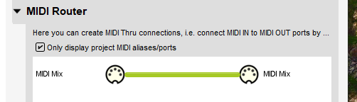

I set up preset 0 translator routing to and from MIDIMIX.
I don’t put any MIDI thru path so knobs and faders will do nothing but you could add that path if you would like. You might want to also determine if you want to send the MIDI messages elsewhere with either a thru path, another translator (with different routing) or both.

For an all momentary version, you simply need to have no translators and add a MIDI route from and to MIDIMIX since they are already Momentary.
You could also add a blocking translator with an incoming action of any CC on any MIDI channel with an outgoing action of none so that the knobs and faders don’t loop back to themselves.
