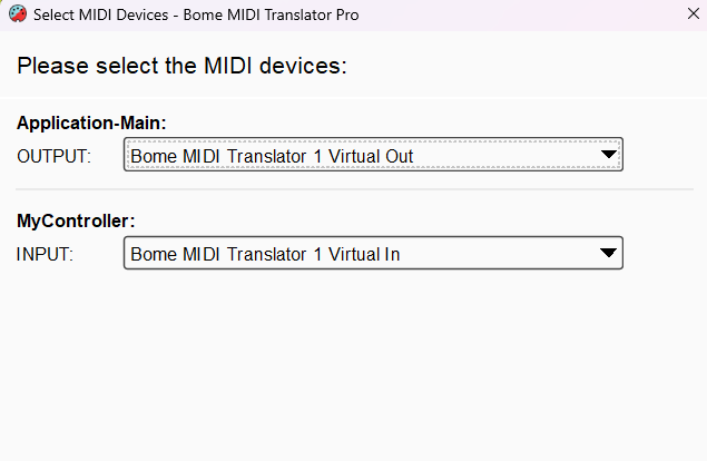

Translator 1.0 (Preset 1 translator 0) handles note-on to CC with value of 127
Translator 1.1 handles note-off to CC with value of 0.
I set up my aliases as follows. You will need to adjust them to the physica (or virtual) devices that you use:
note-to-cc-example-2025-10-16.bmtp (2.1 KB)
