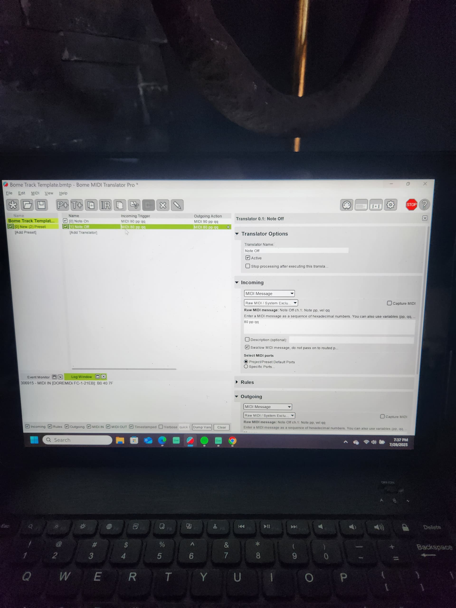

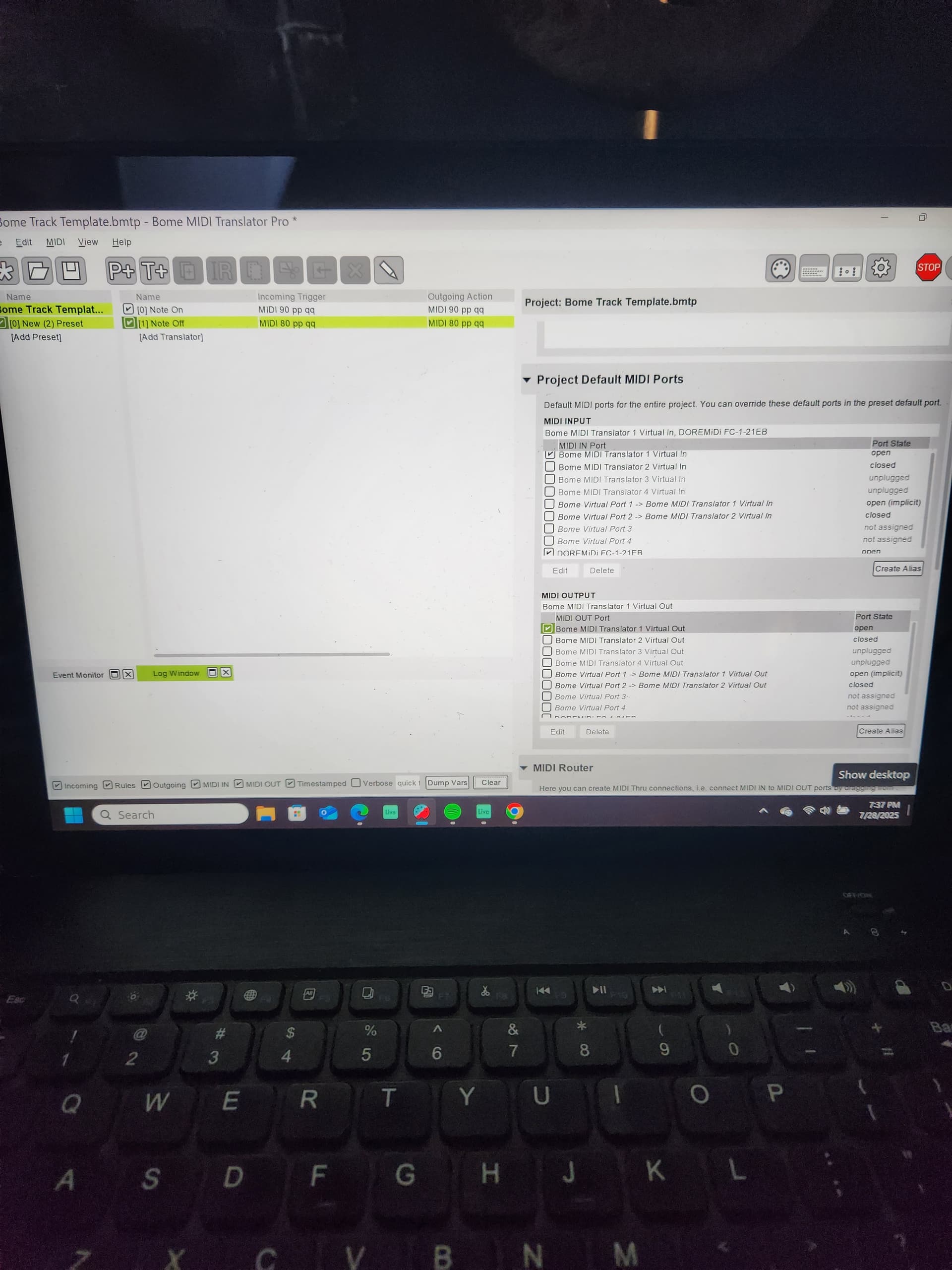

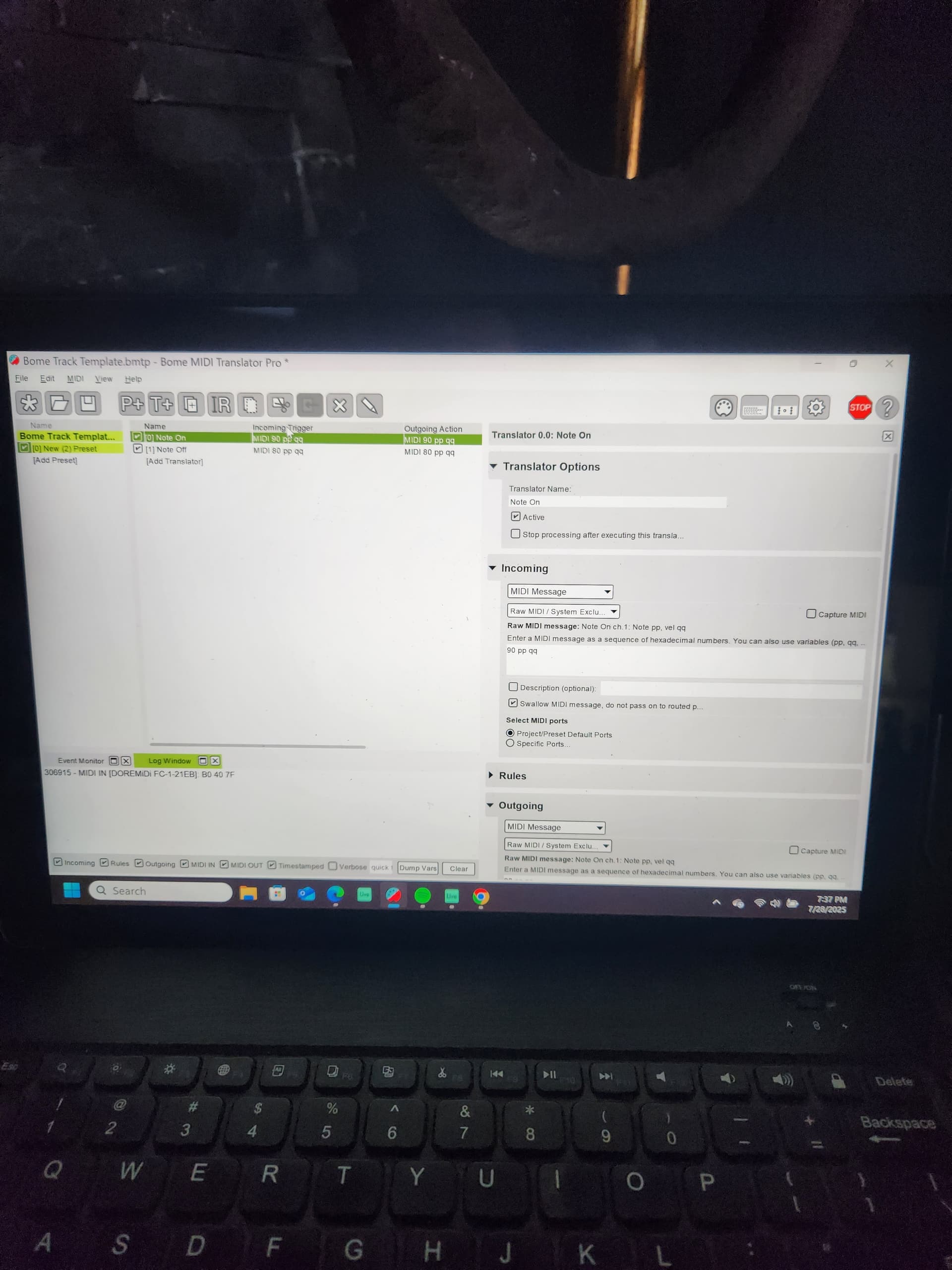

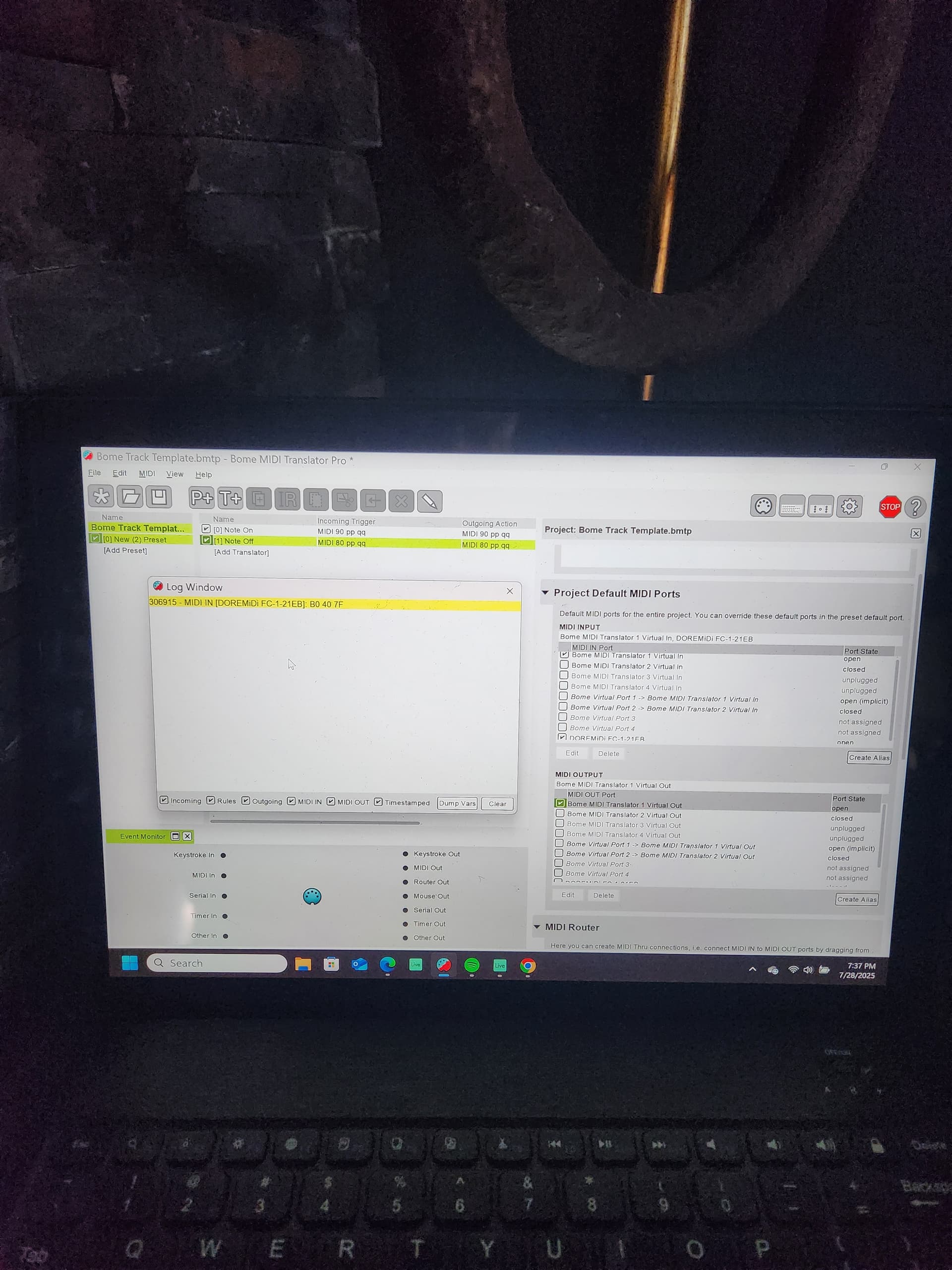

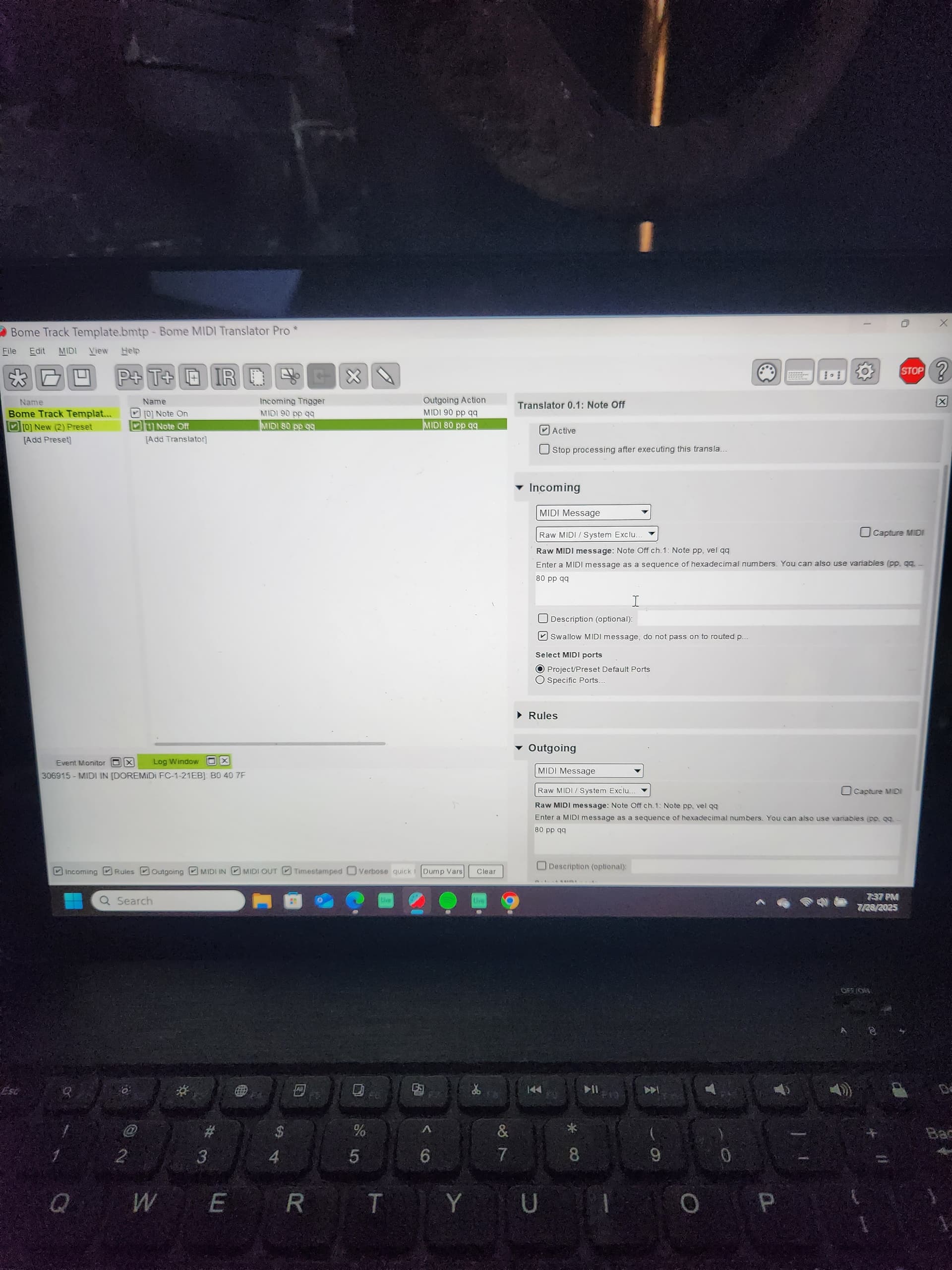

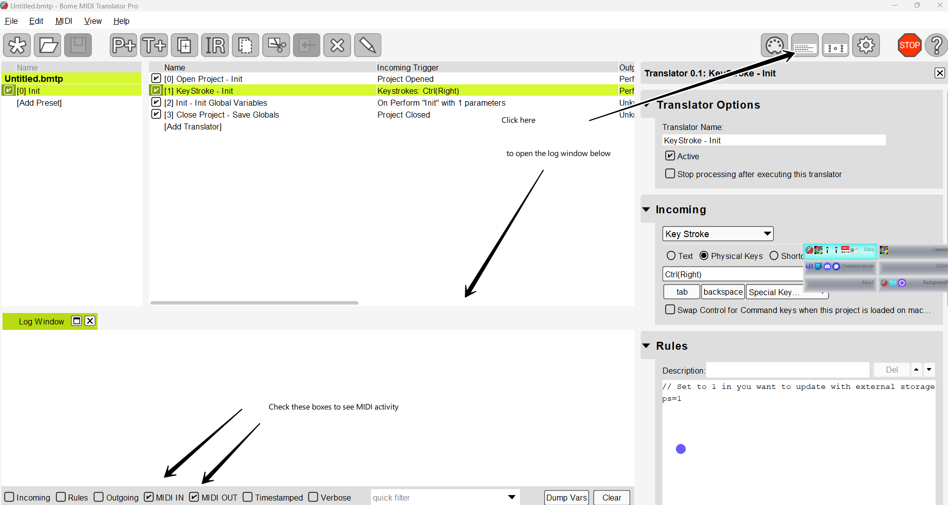

Well… I tried disconnecting and closing the software and Ableton as well as disconnecting the MIDI switch I’m using. I then opened TP then Ableton then powered the switch. I still can’t seem to get it to output MIDI. Here are a few pics, apology for the camera pics, my screenshot is not working on my laptop. To recap what I’m doing is sending a MIDI msg from a footswitch to TP for translating into an identical MIDI msg and sending to Ableton. What is next to try?
Hi, I see your DORE MIDI (I assume from your footswitch) is sending B0 40 7F which is CC 64 (40 hex) on MIDI CH 1 with velocity 127 (7F Hex).
Your translator is expecting a Note-On MIDI CH 1 any note any velocity and
Note-Off MIDI CH 1 any note any velocity.

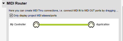

If you want the original message to get through you can draw a line from your input device to your output device in the Bome MIDI Translator Pro midi router.
If you want to translated to a different message you need to write another translator with the desired input and the select the output you want to send.

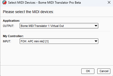

In my case I’m using the following aliases:
Here is the routing for MIDI thru path (messages without translators).
For translator routing you need to use device selecion.
