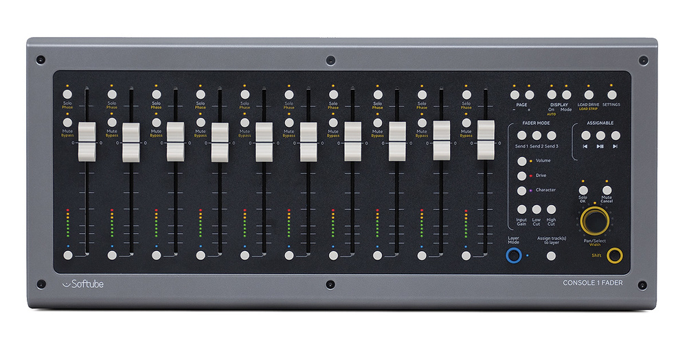

Thanks for the quick reply. So the Console 1 Fader has 10 faders and the ability to page through banks of faders.

Does this help? Here’s a screenshot of the controller
So you can see there are 10 channels with the ability to select individual ones, solo/mute, toggle between pages of channels, etc.

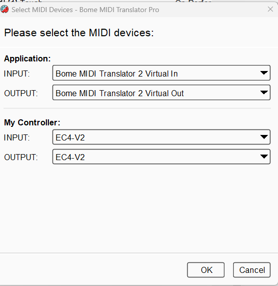

OK, that is enough to get started. Find the attache project file
Make sure you sent your input and output ports to the same virtual port within ProTools and Bome MIDI Translator Pro
Here are my ports. I’m using a different controller to emulate yours.

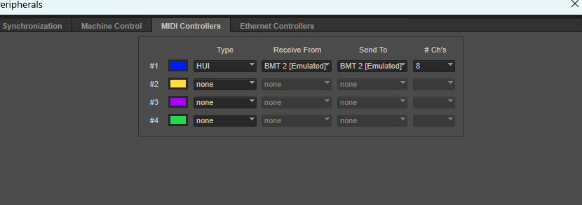

ProTools looks like this:
I have only set up 2 faders and one VPOT (Pan knob)
Translator 1.0 handles the 2 faders. It sends a touch command (1.1) when the knob is first moved and after 100ms of non-movement it sends a release command (1.4) which is handled by a timer.
Translator 1.3 handles the Pan action for the current channel. I I would need to know the value for each selected channel to expand that beyond the current channel. Right now it is just set to the channel of the last fader move.
