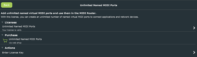

You can purchase Unlimited Named MIDI Ports here.
It is an add-on to Bome Network. You don’t need Bome Network Pro unless you need to send MIDI between computers. You can download Bome Network here.

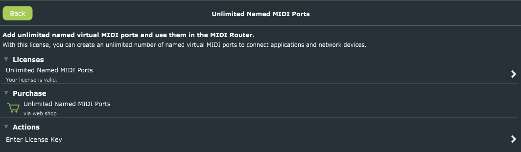

Once Bome Network is installed, open it and with the gear ICON, you can enter your license name and key.

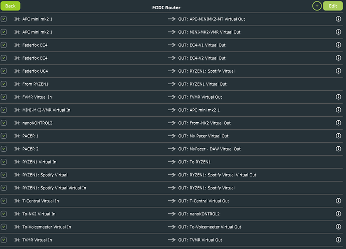

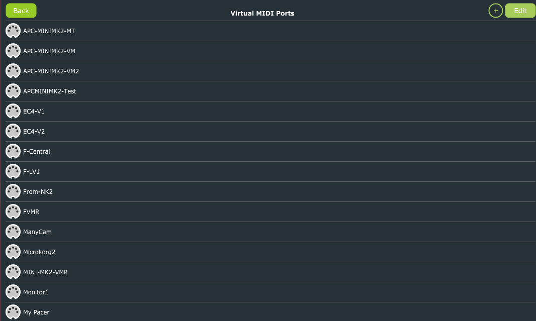

Once purchased you use the Bome Network tool to add ports and then routes.
Routes are needed because when you create the ports, they are only endpoints.
This post, describes the types of routes and provides some examples.
