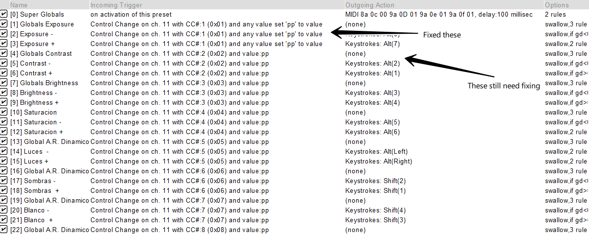

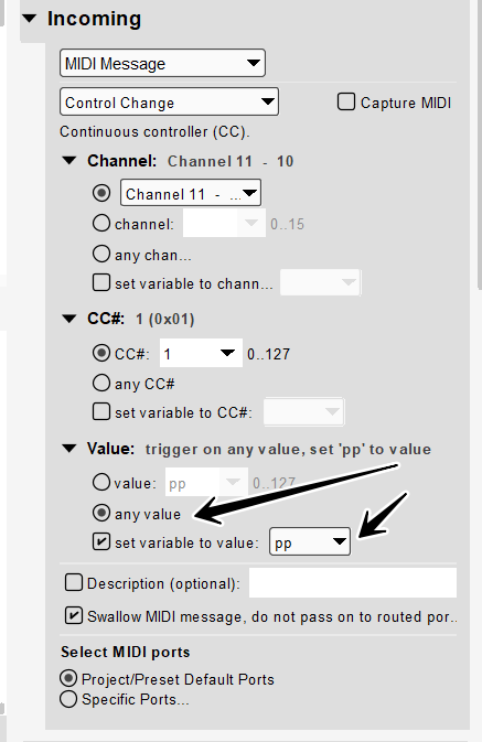

Hi, I apologize. I didn’t look at your project file and now I realize you are sending keystroke outputs. I noticed the incoming MIDI messages on many of the translators are not correct. I fixed translator 1-3 in preset 0. I’m not sure why it even worked with version 1.8.1
The others still need to be adjusted.
Here is the detail on translator 0.1 as it is fixed.

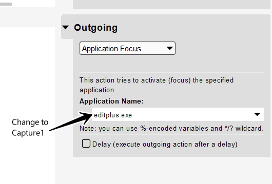

You could also add a new action to ensure that your application if focused prior to sending keystrokes.
I created a new preset and translator for this (2.0).
You will have to change the outgoing action to focus on CaptureOne instead of Editplus though (I don’t have CaptureOne on my computer0.

You are looking for the value of pp which is a local variable and by definition the value is not defined so it can be any random value unless it is initially set.
In section 10.3 of the manual you will see this.
Note that Local Variables are not pre-initialized: if you don't define them in the
Incoming Action, and you don't set them to a value in a Rule, a Local Variable can have
any (random) value
So it is perhaps by chance working on 1.8.1.
