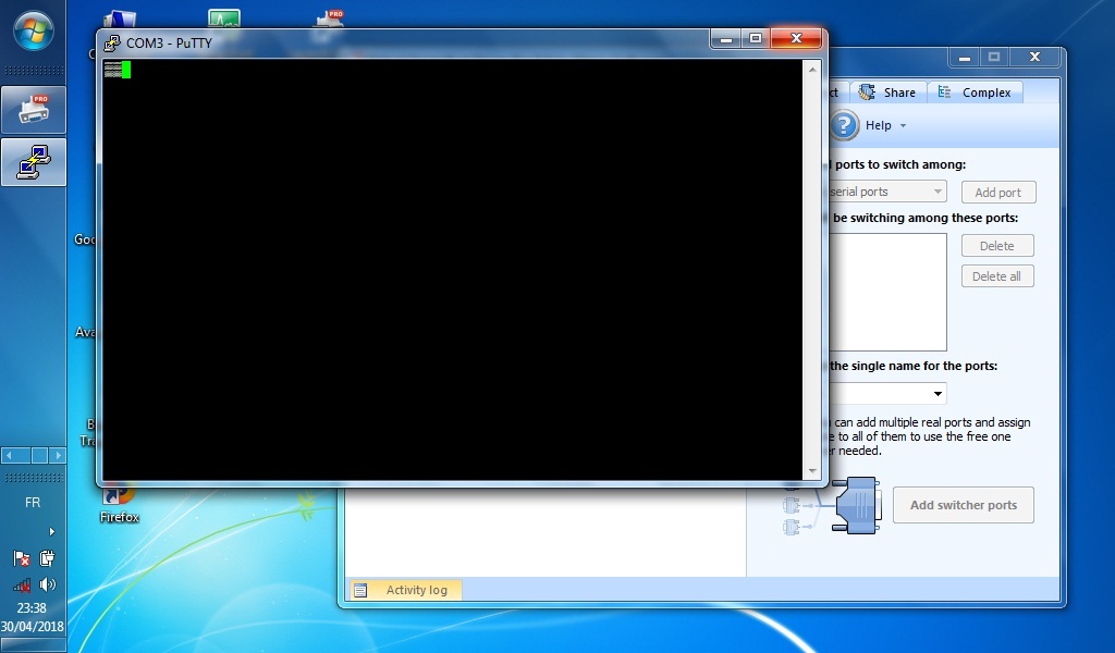

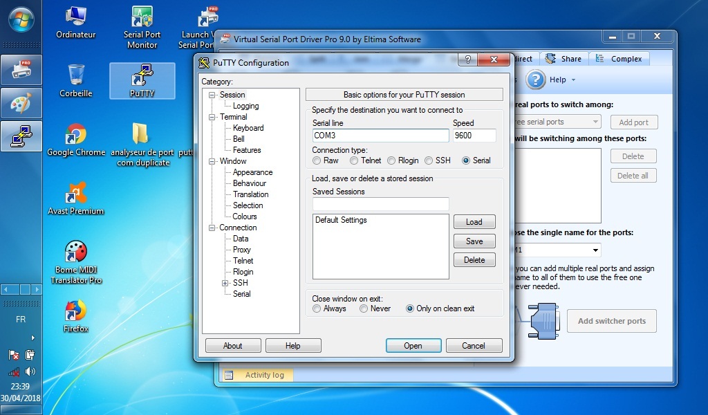

I saw in one of your messages you use puttytel. I installed it. here is the setting.and here is what I get
I found a program that duplicates the com3 port (virtual serial port). this should avoid: access denied
I would do tests tomorrow night Good night
Hi, I’m not sure you will be able to send this data with Puttytel. Puttytel is an ascii based terminal emulator and the bytes I’m seeing are really just hex representation of 8 bit binary values.
Best to open the COM3 port with MT Pro and then send the raw binary bytes from there as you would normally sent MIDI values.
