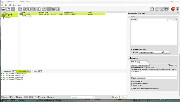

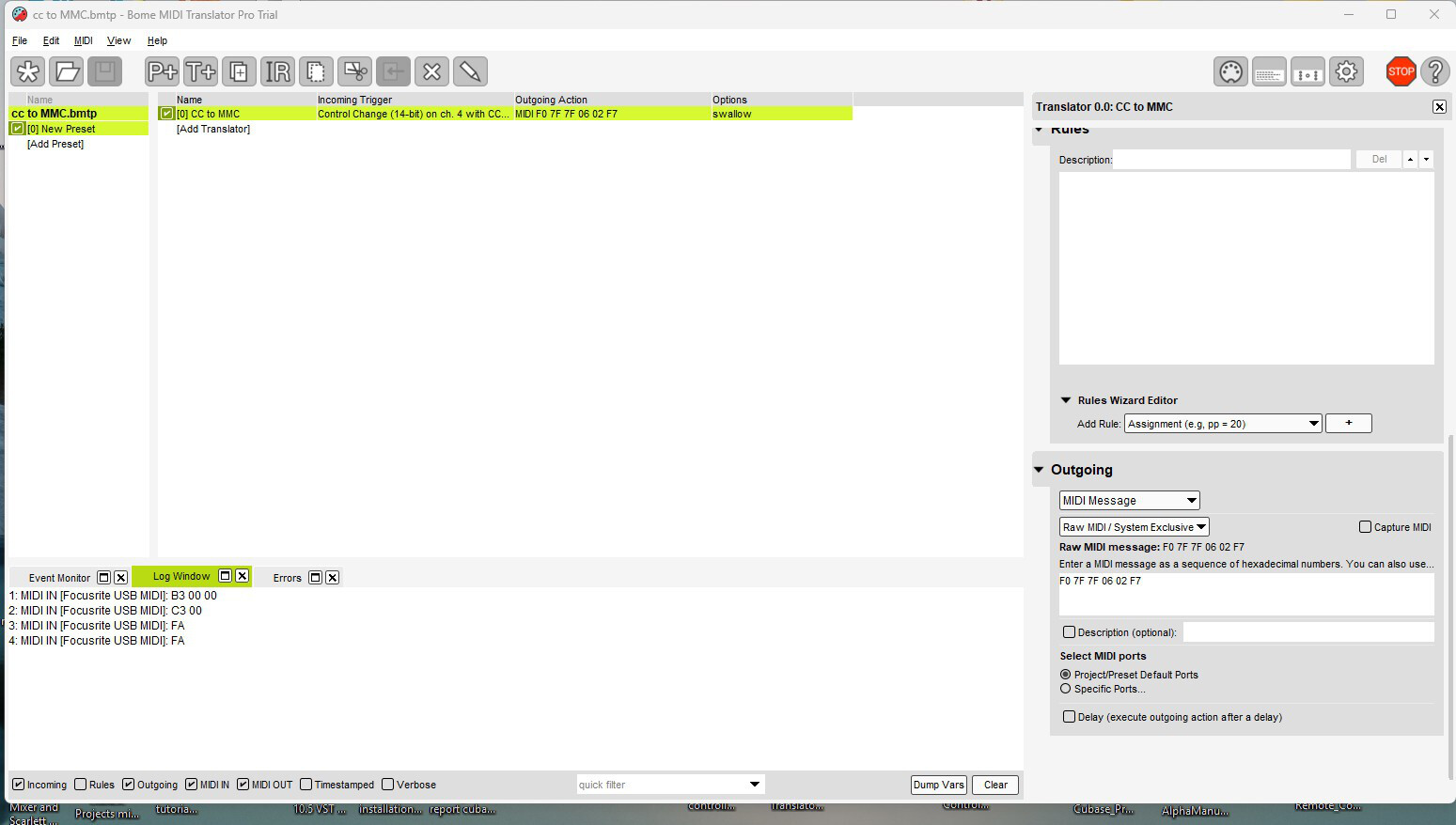

I tried to create a translator for CC to MMC - specifically "play’ to start out. I think I got the correct hex code for play. Here is a screen capture that shows the data in the event monitor when I press the pedal:

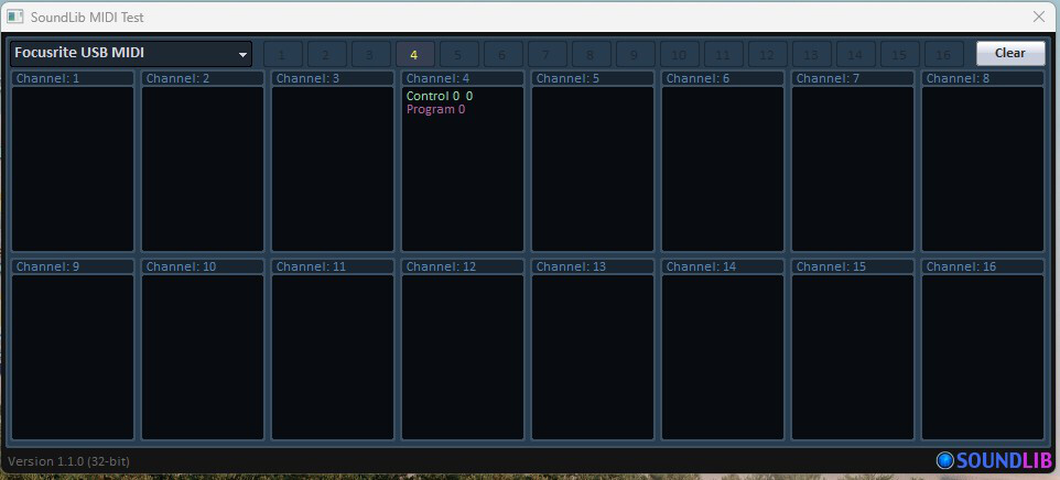

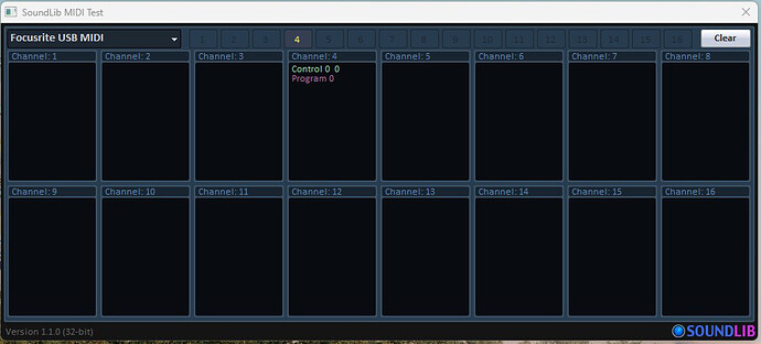

I"m too new with this level of midi - I"m not sure what the info means in the event monitor - especially when I compare it to events as listed in the MID Test app:
First of all, you have the trigger of 14bit CC instead of regular CC. According to your log, you could trigger on
CC 0 MIDI CH 4 value 0
PC change MIDI CH 4 value 0
Start (FA)
The Start message looks good though so you just have to set the right trigger.
F0 7F 7F 06 02 F7
Also, make sure you have checked the right output port.
