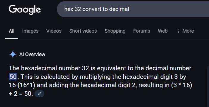

In addition, I often use Windows programmers calculator to help with hex to decimal conversion and back if I need to do something more outside of Bome MIDI Translator Pro . You can also use google search
