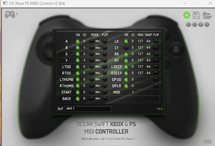

There is a program called OS Xbox PS MIDI Control v3. Which convert xbox Controller Input into Midi CC Commands. Unfortunately i couldn’t transform the midi CC into PitchBend Midi Messages via Bome.
For OS Xbox PS MIDI Control v3 i have to use LoopBE1 to get it working.

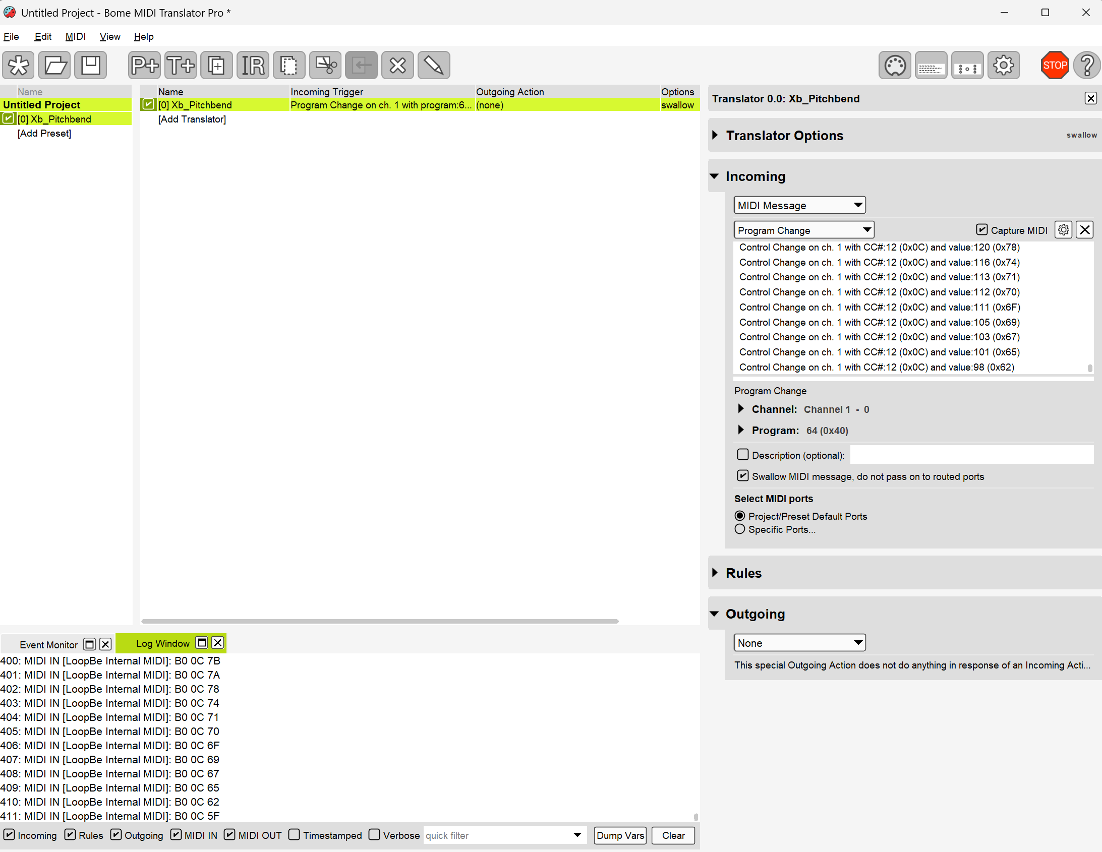

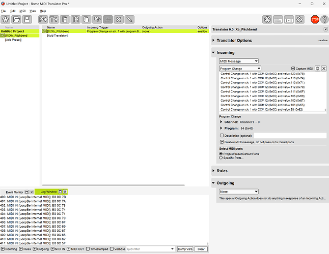

When i open Bome Translator Pro:
For Midi In i use LoopBE1 and for Midi Out Bome Virtual Out.
I dont know how to handle the midi CC?

Xb_Pitchbend.bmtp (875 Bytes)
Here is the project file i use.
CC12 is comming in but i cant get Pich bend out.

Here is a screenshot for OS XBox
You have not defined an outgoing action in your translator for pitch bend.
