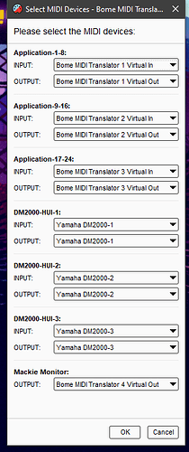

I set up Aliases DM2000-1-HUI through DM2000-3-HUI to connect to your controller. Just assign them the proper as attached.
I set up Aliases Application-1-8, Application-9-16 and Application-17-24. Assign them to the virtual ports BMT 1 BMT 2 and BMT 3 respectively for Ableton Live. (BMT 1 = Bome Virtual Port 1 ..)

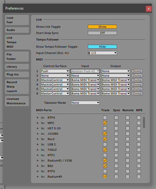

In Ableton Live, set up the top section as shown below in the first attachment.
Then turn remote on on BMT 1, BMT 2 and BMT 3 as shown in the second attachment.
Then everything should look like a Mackie MCU control surface for Ableton Live while your DM2000 is in Mackie HUI mode. All faders, solo,pan, mute, transport, V-POTs etc should work and you will have a lot less mapping to do.

Hello,
I just downloaded this BMTP project and am experiencing some issues with Ableton 11.
Instead of getting channels 1 -24 on the DM2000, I am getting three instances of the first 8 channels. And, as far as I know, there isn’t a button that banks the faders. Ableton also starts at bar 7 for some reason, I am unable to move the transport to anything earlier.
Below are my Ableton and Bome settings. For Virtual MIDI Ports 1-3 I am using the MackieControl setting, and for Virtual Port 4 I have it set to MasterControl. I tried changing ports 2+3 to ‘MackieControlXT’ but that didn’t make a difference. All four of the virtual midi ports have ‘remote’ on in the Ableton settings - no sync or track.
I would appreciate any guidance or advice on how to get this working.
–Chris
The first needs to be Mackie Control, The others need to be extender. I don’t remember if remote needs to be on. Try it with remote off because I think the script takes over and you don’t need remote and it might be interfering with something.
Make sure in the Bome project file that you are sending the the aliases and not directly to the virtual ports. You should check this at the preset level as I believe this is how the script was written.

Thank you for the advice.
I turned off remote on the virtual ports. I have also set the first port to MackieControl, and ports two and three to the extender. I stopped using virtual port four altogether.
This fixed the transport issue, and I am now able to adjust fader level, pan, on/off, and arming for the first 24 tracks.
There are still two issues at hand. The first of which is that the ‘scribble strips’ are only visible on the first eight channels. The two MackieControlExtender ports do not display the track text on the console. The second issue is that there isn’t aren’t ‘bank’ buttons. I am only able to control the first 24 channels, and unable to access any of the subsequent channels in the Ableton session.
