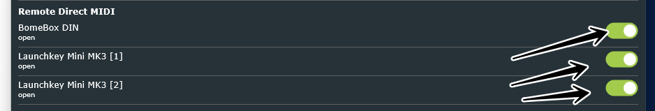

In order to see your remote ports on your BomeBox or another computer, you need to turn them on in Bome Network Pro using Remote Direct MIDI switches.
The below example shows exposing the BomeBox attached ports on my Windows 11 PC. First, I click on FOH (which is one of my BomeBoxes). This is done on my PC using the Bome Network tool.
Then you can see the ports attached to my BomeBox. Turn on the switches to expose them.
You should then be able to see the MIDI ports in GiG Performer (and other applications). I’m showning FOH:BomeBox DIN .

Thanks Steve, but unfortunately that wasn’t the problem here (I already had the ports enabled).
