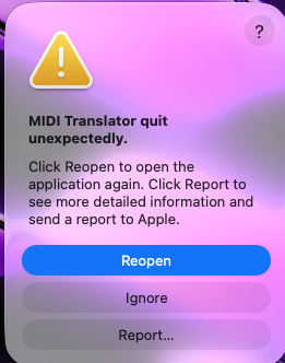

After installing MacOS Golden Gate on my M4 MacMini, MTP crashes when shutting down (even if shutting down with no project open). Otherwise MTP seems to run fine.

Thanks for replying Steve - The crash occurs when shutting down MTP. MTP works normally (I run a fairly complicated MTP project to manage my midi pedal interactions), but when quitting MTP, I get the crash message below. This occurs even if no project is open in MTP at the time I quit MTP (if I start/end MTP with no project active, I’ll still get that message at shut down). This issue started when I installed MacOS Golden Gate earlier this week. Good to know it’s not happening at your end which suggests it might be something other than MTP causing it here (tho MTP is the only app I’ve found that’s started doing this). It’s not too serious since it only happens at MTP shut down, but I’d like to track it down since obviously something is amiss.

Hi Paul, Helen, thank you for your further info.
However, I can see in the logs that you’re still using an old version of Bome MIDI Translator Pro. The latest version (at this time) is 1.9.2. Download in your account:
https://www.bome.com/account/products
PS: v1.9.1 (which you’ve been running) had this problem since a recent MacOS update, which changed certain things we were using. We’ve worked around this and fixed it in 1.9.2.
Can you confirm you’re running v1.9.2 now? The About menu item will tell you.
Woops - you’re right - I’m on 1.9.1 - don’t know why I thought earlier I was at 1.9.2. Updated to 1.9.2 now - no error - thanks - sorry for the mixup.
