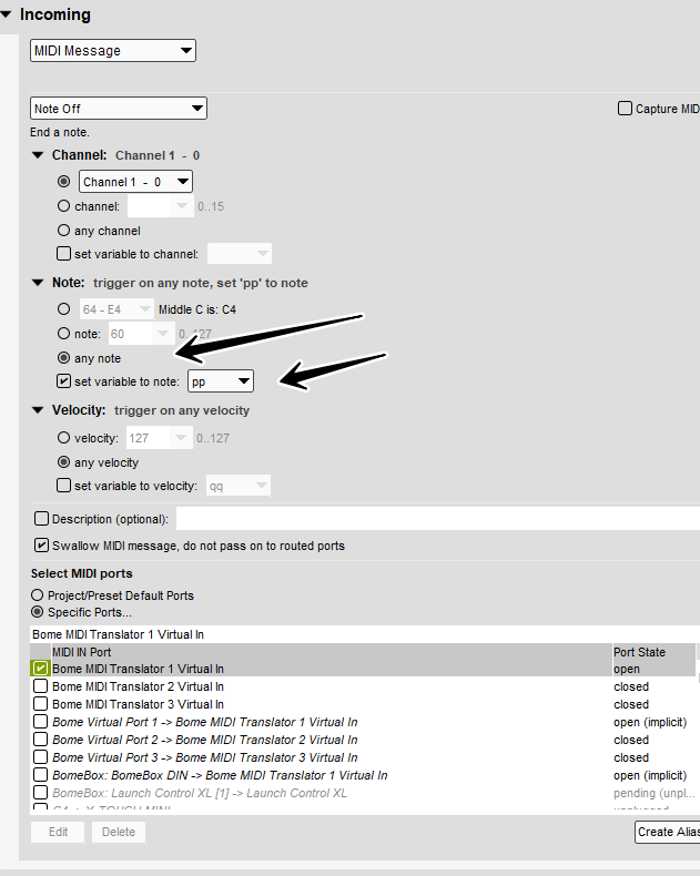

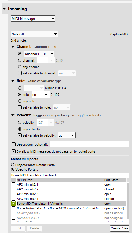

You will need to add translators for buttons greater than 63 to accept note-off messages and send to the desired controller in the form of note-on with velocity 0 to turn off the LED. The easiest way to do this is to use raw MIDI for output.
Incoming - Note-Off MIDI CH (1 or 2 depending on the target device). Set note to pp.

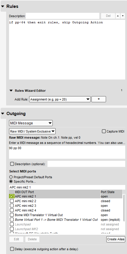

Rules
if pp<64 then exit rules, skip outgoing action
Outgoing - Raw Midi 90 pp 00 to (whichever target device you want).
I feel like I have something wrong, it’s not switching off
Please ignore, I got it! Thank you!
Yes, this is what you needed to do. See arrows.
