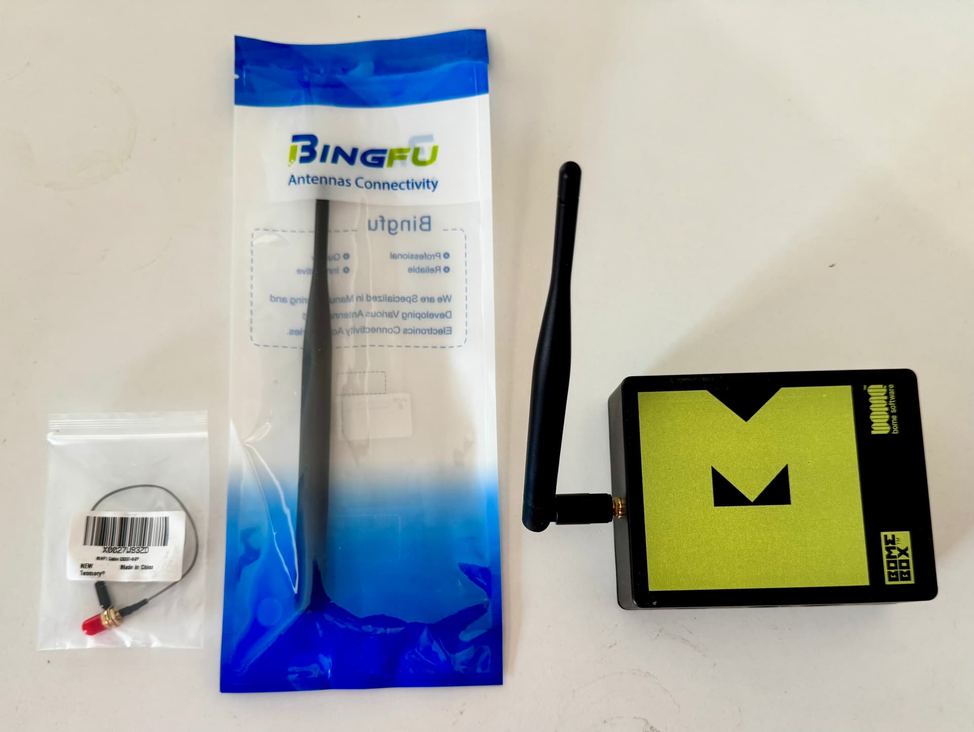

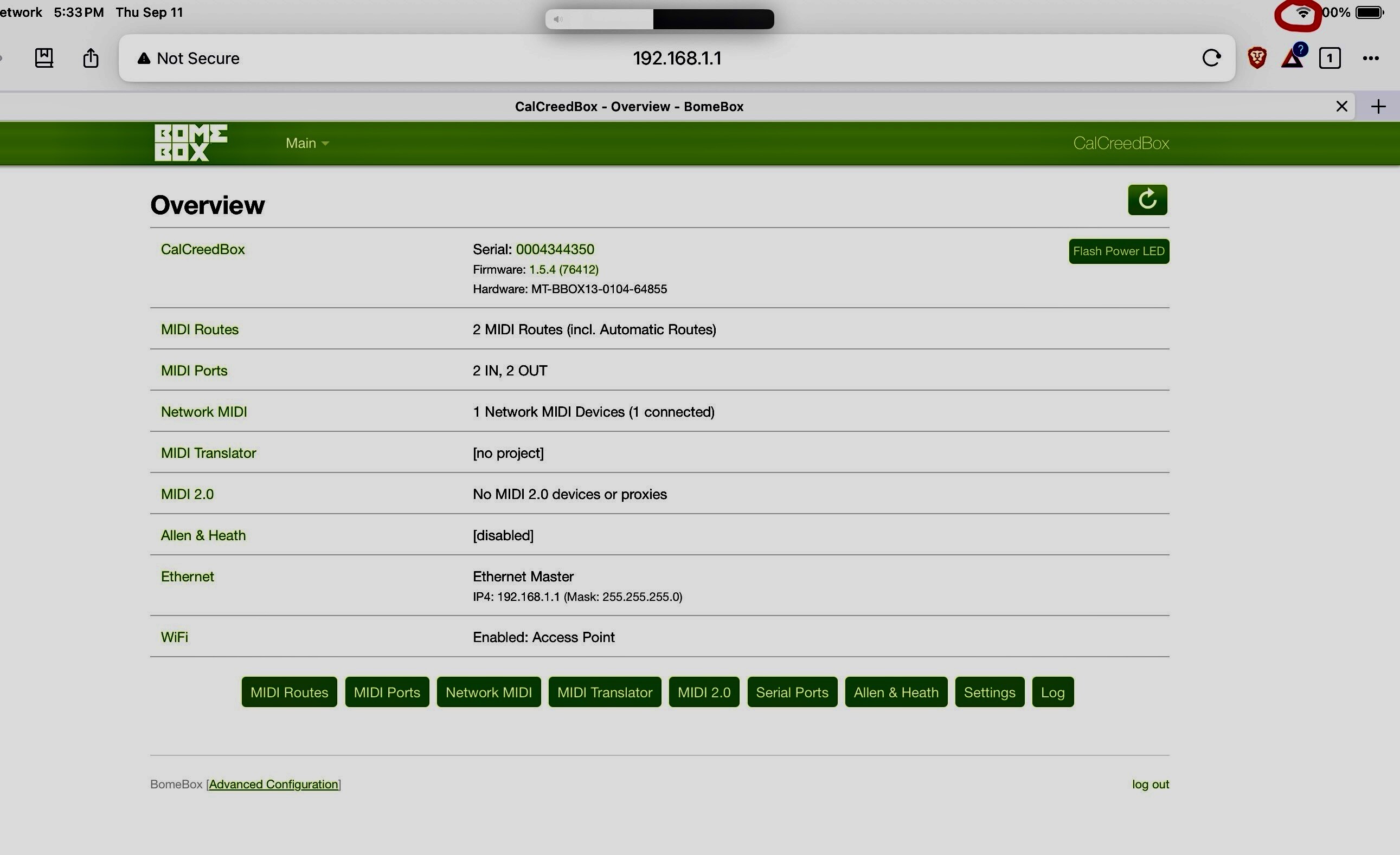

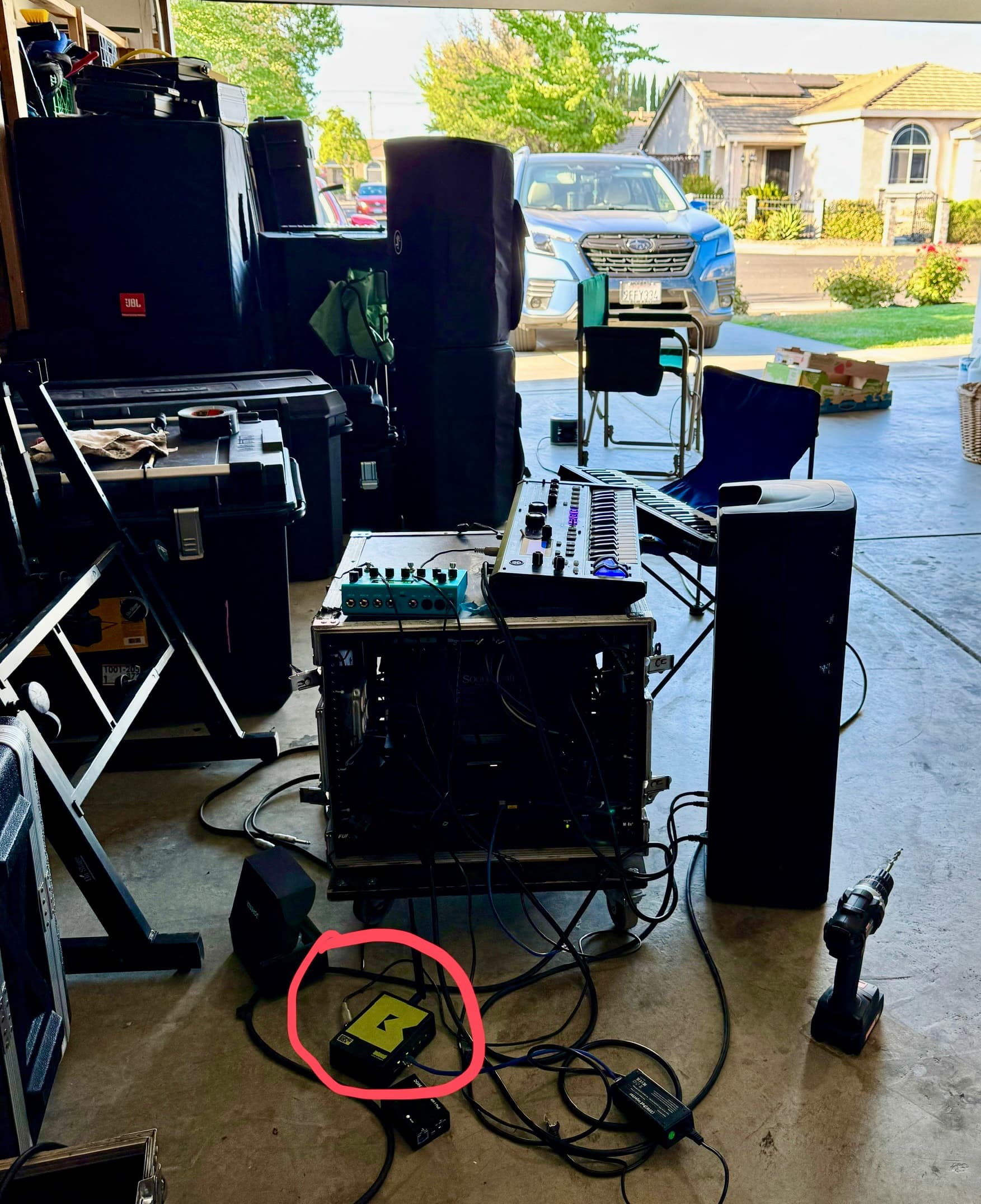

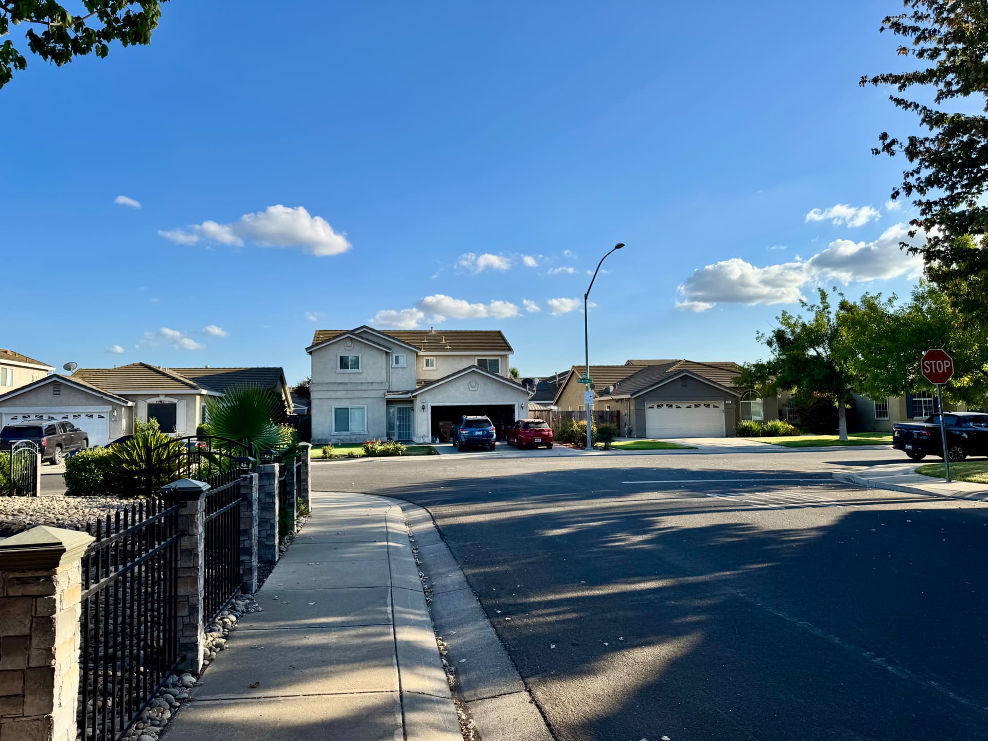

I installed the antenna and the results were good! Although I have no baseline for pre-antenna, the range seems more than adequate. The attached pictures indicate the following.
  1. BOMEbox antenna installed with the items next to it. The drilled hole was a 5/64 size drill bit
  2. Is the location of the BOMEbox in the back of the garage
  3. Is the distance from the BOMEbox
  4. Is, at that distance, the fact that the BOMEbox remains connected with good signal
Not in that order as shown
Awesome. Thanks for the pictures!
