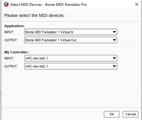

This is how I would do it.
  • Set up a Bome MIDI Translator Pro project with MIDI thru paths from your APC-MINI MK2 to Bome MIDI Translator Virtual 1 and visa versa. Optionally you can create aliases like ‘Ableton’ from Bome MIDI Translator Virtual 1.

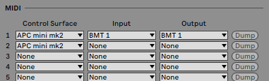

  • In Ableton, Set up MIDI remote script as APC MINI MK2 but instead of selecting the APC-MINI device, select BMT 1 That way everything will pass through Bome MIDI Translator Pro between Ableton and your controller.
  • Activate a clip and then in the Bome MIDI Translator Pro screen, turn on MIDI IN so you can see what MIDI it is sending.
  • Create a Preset and set it’s routing from Bome MIDI Translator Virtual 1 (or better still the aliases you created earlier) and to your APC MINI MK2. Any translators in that preset will only look at those ports for input and output

Set up your aliases in MT Pro as follows.
Then set up Ableton Live as follows:
Any empty clip will have LED off. Any running clip will be red, and any stopped clip will be white.
APC-MINI-MK2-Custom-Mapping.bmtp (2.2 KB)
Make sure you have BMT1 unchecked in the lower section, otherwise they may interfere with the MIDI Remote Script.

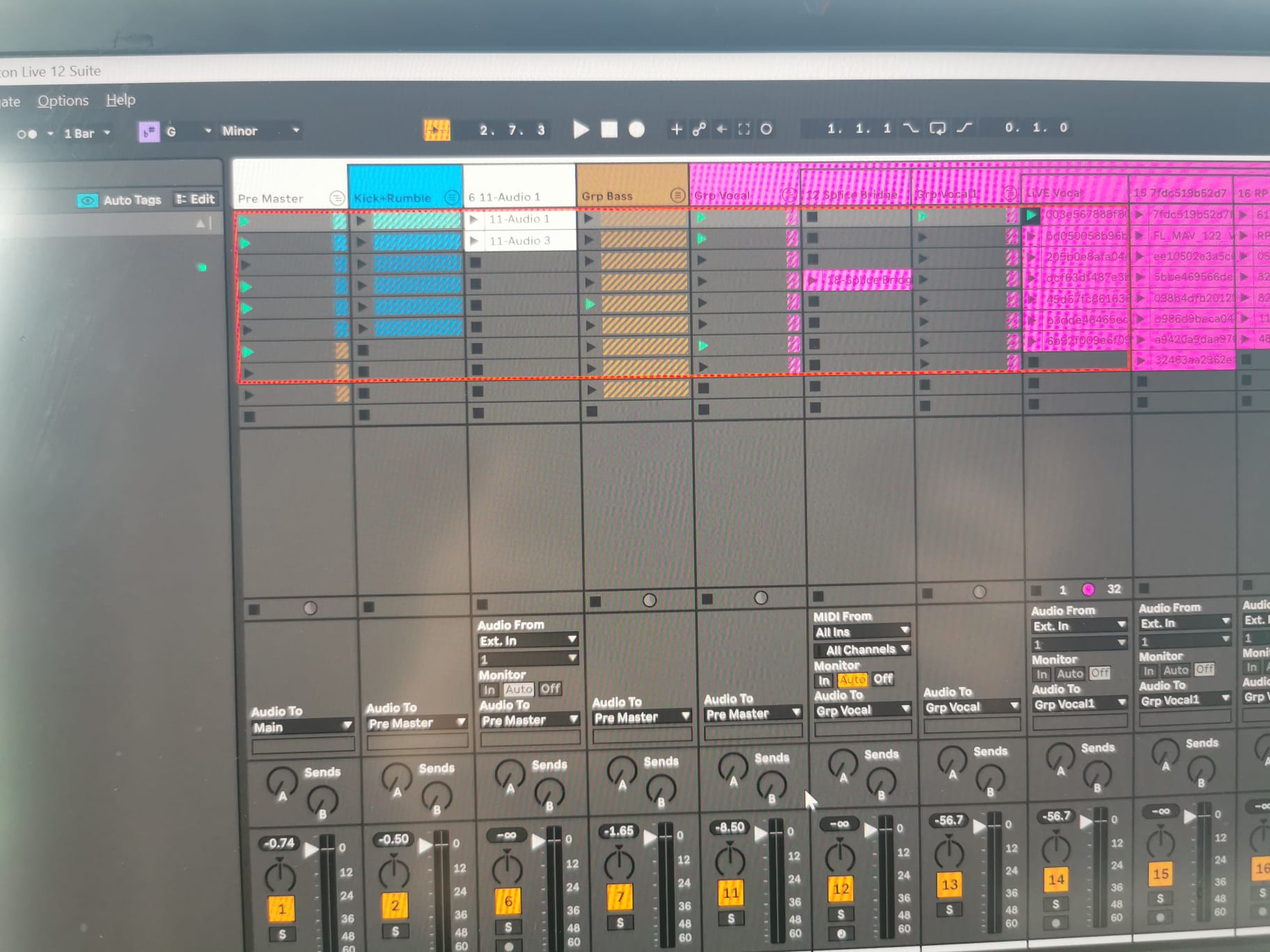

Unfortunately I get this red frame which makes my custom mapping obsolete…
